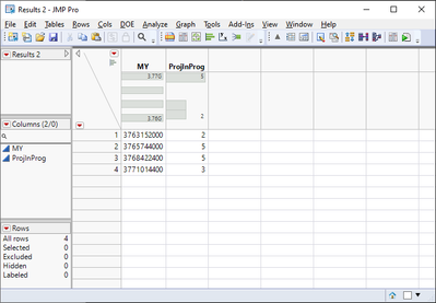

dt_results = New Table("Results",
	New Column("MY", Numeric, Continuous, Values(aa_results << get keys)),
	New Column("ProjInProg", Numeric, Continuous, Values(aa_results << get values)),
-Jarmo
