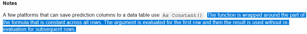

ps.  In my goal to learn a little bit from you at every interaction ;) -- why does this approach need the "As Constant()" function?  What would happen without it?

If you need a formula, I'm not sure how well Python would work. As Constant() is there to prevent getting the list of names again and again on each row.

You don't want to evaluate values which won't change on each row of the formula execution. That is what As Constant() does, it makes JMP to evaluate that expression only once, on the first row.
As Constant(expr)
I think you could basically replace it with (most likely not exactly the same, but quite close)
If(Row() == 1,
	n = :name << get values;
-Jarmo

There are some useful links from JMP Help but I can quickly only find this one:
