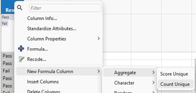

JMP can only count Number - not Strings.
... at least bast on the available options in the right-click-menu.
From JMP19 onwards, JMP can also count unique Strings:
But still: no 1-click-appraoch to count strings.

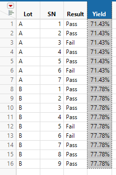

to calculate the yield via a column formula, you can use:
New Column( "yield_",
	Format( "Percent", 9, 2 ),
	Formula( Col Sum( :Result == "Pass", :Lot ) / Col Number( 1, :Lot ) )
