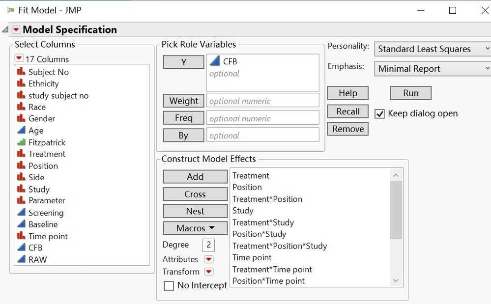

Hello all,
I'm new to JMP (JMP15) and only familiar with limited analysis.
 positioninstant24h48h72h100h
test A
A, BYYYYY
test BA, BYYYYY
test CAYYYYNA
To simply explain my dataset, with me have data at most time point. only test C didn't have 100h data. Test A and B had tested on both A&B position. Test C tested on A only.

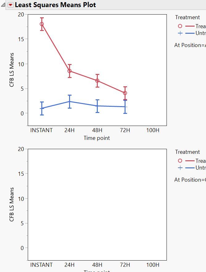

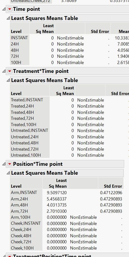

The output from Fit model contains a lot Non-estimable. no results for all the items related to timepoint or position. Table and plot. How should I set in JMP to analyze dataset with missing data smoothly (should be achievable I believe)?
Thank you!

It would help if you can attach an anonymised version of your data. There are different reasons why some of the model effects might be NonEstimable. It is a complex model that you are fitting so it might be that you don't have enough observations. Or it could be because of aliasing. It is difficult to know from the information that you have provided.

Based on the small dataset you included, I believe the issue is Site2. Not all of the time points were observed AND not all of the positions were observed with Site2. Your model includes the Position*Site interaction and the Site*Time Point interaction. You cannot estimate all of the levels of those interactions because you do not have enough data (specifically, the missing combinations with Site2).
If you hide and exclude the Site2 data from the analysis, the non-estimable terms go away. Alternatively, you could remove the Position*Site interaction and the  Site*Time Point interaction from the model.
