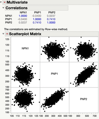

Unless you have a specific reason to use Graph Builder, take a look at 'Analyze > Multivariate Methods > Multivariate' which should be more suitable. For example:

I forgot to mention that I did use the Multivariate method, but my matrix size is 12*8 meaning there are 96 different correlation graphs. Is there an option to export all of these graphs in one click? or at least to enlarge them in order to view them larger?

The Multivariate platform lets you grab the edge of any of the graphs in the scatterplot matrix and expand the size of the graph, and it will automatically expand the size of all of the graphs.
