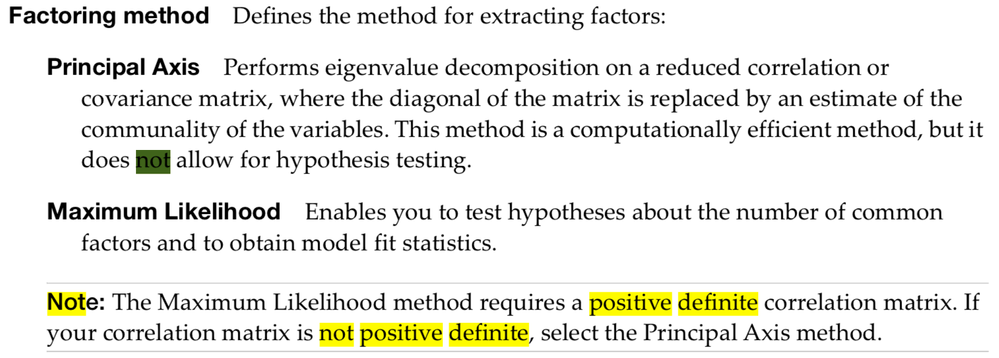

I am trying to do a factor analysis (PCA) on a large data set. It has 181 columns and 163 rows, values are between -6 and 8. I have started the factor analysis and the eigenvalues and scree plot looks good.Below all the factors it says: "Warning: the Correlation matrix is not positive definite". Can someone help me understand what it means?
I try to perform the analysis using Maximum Likelihood and Common Factor Analysis with a Varimax rotations method. But I get an error message saying: "Maximum likelihood method requires a nonsingular correlation matrix. Switching to principal components method may fix the problem."

Re: Correlation matrix is not positive definite and singular?
You mentioned that you are a new JMP user. (Welcome!) You did not say what is your level of knowledge and experience with the PCA methods.
Select Help > Books > Multivariate Methods. Search for "not positive definite." I found this information:
