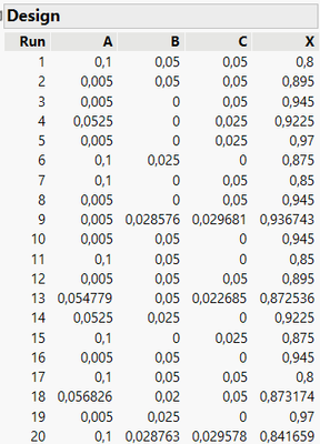

  • Either design it as you intended to do, with a Custom mixture design and adding solvant X as a mixture factor so that the total quantity is 100%. The drawback of this approach is that you use one factor in which you're not particularly interested in (ratio/quantity of X, that you could deduce from other components quantities, and that is not supposed to "interact" with other components). This mixture approach, combined with a model with main effects and 2-factors interactions, may require a recommended number of runs of 20 (if you add all 2-factors interactions between any component and X) :
    Resulting 20-runs mixture design :

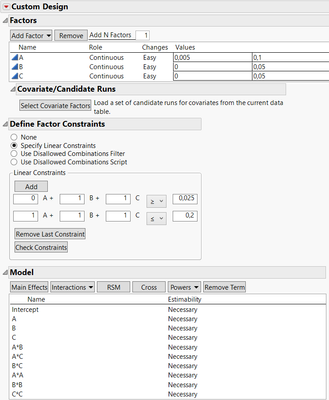

  • Another option could be to design an I-optimal design with the platform Custom Designs for A, B and C, setting the two linear constraints (B+C > 2,5% and A+B+C<20%), and specifying a Response Surface Model with all main effects, 2-factors interactions and quadratic effects :
    The default recommended number of runs for this design is 16 runs :
     You can create a formula in the datatable to calculate the quantity of X you need to add to have formulations at 100%.
