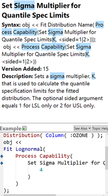

Here's the script for performing the K sigma multiplier 'in script' - you can find details in the Scripting Index (see screenshot below).
Distribution(
	Stack( 1 ),
	Continuous Distribution(
		Column( :Example ),
		Horizontal Layout( 1 ),
		Vertical( 0 ),
		Fit Normal 3 Mixture(
			Process Capability(
			Set Sigma Multiplier for Quantile Spec Limits(
			4),
				Show as Graph Reference Lines,
				Nonnormal Capability Method( "Z-Score"n )
	SendToReport(
		Dispatch( {"Example"}, "1", ScaleBox,
			{Add Ref Line( 2.20020487561508, "Solid", "Blue", "LSL", 1 ),
			Add Ref Line( 4.81371452626116, "Solid", "Blue", "USL", 1 )}
Distribution(
	Stack( 1 ),
		Column( :Example ),
		Vertical( 0 ),
			Process Capability(
			4),
	SendToReport(

Hi Ben,
Thank you so much! This problem have been confused me for at least 1 month. Really appreciate your help!!!
