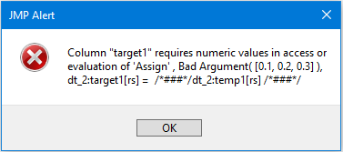

I don't  know why this isn't working. I select rows who are empty, select a seccond column and try to copy them into the empty ones.
Both columns are numeric and it worked sometimes with other tables.
Sample table ans script is attached.
dt_2= data table("Untitled 20");
dt_2 << Select Where(Is Missing( :target1));
rs = dt_2 << Get Selected Rows();
if(nitems(rs)>0,
	dt_2:target1[rs] = dt_2:temp1[rs];
	dt_2:target2[rs] = dt_2:temp2[rs];
	//dt_2 << Delete Columns( :temp , :temp2 );
Alert:
THX

  1. In your provided data table, your "temp" columns are "temp" and "temp2", not "temp1" and "temp2"
  2. You need to loop through the assignments.  A JMP data table can not handle assignments where the right hand argument has multiple values.  See my changes below

This works, but I try to avoid for-loops.
It works with an array, but not with the table itself:
temp = dt_2:tartet2 << get values();  // copy row from target
temp[rs] = dt_2:temp2[rs]; // replace the values in the array
dt_2:target2 << set values(temp); // re-insert into target
