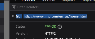

Open Developer Tools in your browser (F12), select Network tab and go to jmp.com. From there take a look at the domains / files and try to find "correct one":
Now try opening that one.
This approach might work or at least get you closer, depending on the website and what you want to get from there.
-Jarmo

I had a look in the developer tools but didn't manage to crack it yet as a command.

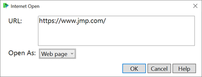

i managed to get the html of http://jmp.com/ by performing the following steps:
1) file>> internet open >> webpage.
2) open jmp.com as a webpage
3) accept / not accept the cookies interactively
4) run the following statement:
page = open ("https://www.jmp.com/en_gb/home.html")
notes: cookie approval only lasts within the same jmp session. After that preferences are not remembered.
This method is useful in my case since only fetch information from one domain in each session. therefore, approving manually is not too difficult. if the scrip crosses domains while fetching data it would be nice to somehow automate this.
this method also worked for the webpage i was actually fetching data from so it is reliable to that extent.
