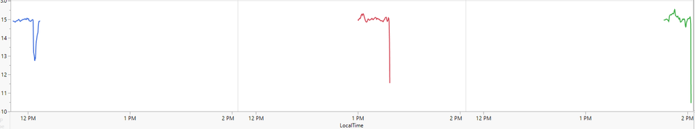

I have a data table with the columns "Time" (Numeric, continuous, formatted in 12-hr h:m:s) and "Name" (Character, just a list of the experiment to which each time point is associated). When I graph using other columns not mentioned here as the Y-axis, and Time as the x-axis, the issue arises where each plot between x-grouping variables is shifted since the x-axis scale remains the same between x-grouping variables (Figure 1).

Figure 1. Each x-grouping variable is a "Name" column variable with "Name also as the Overlay.

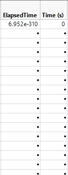

Unfortunately, that returns the column "Elapsed Time" seen in the figure below.
I tried the following code, which yielded the column, "Time (s)" in the figure above as well. Seems like it's doing the set inititial to zero function, but not converting anything else.

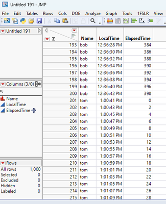

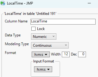

There may be something unexpected about your :LocalTime column.  I tried my formula on a made-up table, and it worked as intended.  How is your :LocalTime column formatted?
txnelson
Re: Converting time to time intervals and resetting based on second column values to prevent x-axis offset
I created an example data table
And then I ran the following JSL

An got the following output
