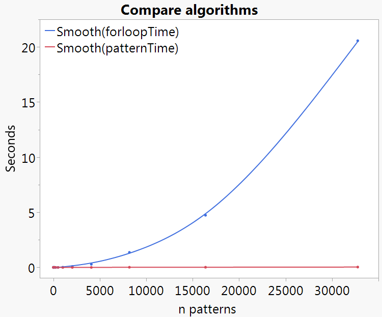

Craige_Hales
Re: Covert a string to a list
Another technique:
parts = {};
rc = Pat Match( "1234567890abcdefghijklmnopqrstuv", Pat Repeat( Pat Len( 4 ) >> parts[N Items( parts ) + 1] ) );
Show( parts );
parts = {"1234", "5678", "90ab", "cdef", "ghij", "klmn", "opqr", "stuv"};
Jim's approach is better for short strings because the next person that maintains the JSL will understand it. For strings that are 10K or so, the pattern matching will be noticably faster.
The pattern match (red curve) avoids reprocessing the stringThe pattern match (red curve) avoids reprocessing the string
The is the JSL to make the graph...

The reason the for loop example slows down on large strings: the substr function must find the location of each substring, starting from the beginning. The pattern match moves through the string once.
Craige
