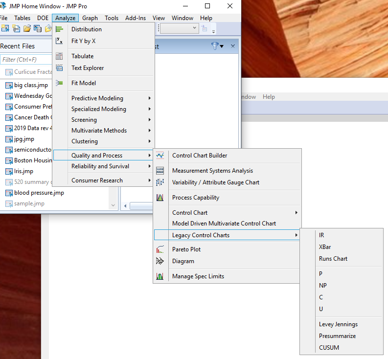

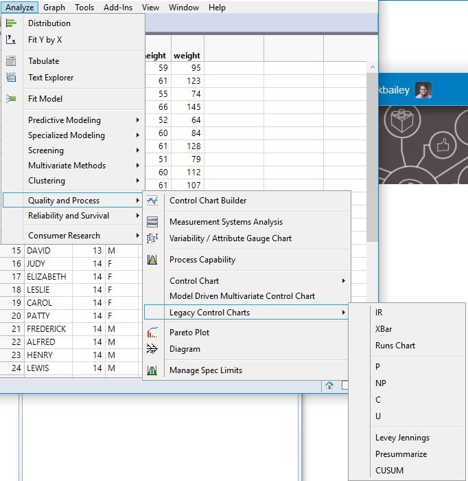

The legacy control charts are still available but deprecated. The newer Control Chart Builder is the preferred platform for making control charts now.

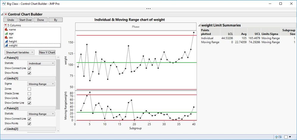

I recommend that you begin to use Control Chart Builder. As an example, I opened Big Class, selected Analyze > Quality > Control Chart Builder. I simply drag the measurement to the Y axis or inside the plot frame to get the XmR chart:
You can select another column with categories and click By. Click Done when you have finished making your charts.

For the control chart, I like to see the time line on x-axis to see the process behaves over-time.

Sorry, I forgot that point. Simply drag the time data column to the subgroup axis (horizontal axis).

It sounds like the issue you are having is that when you click on the control chart that you were used to seeing in JMP 14, the Chart Builder version of that chart is popping up.  You can still get to the older (legacy) version of the charts by selectinglegacy.PNG
