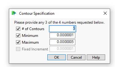

This JSL opens .CSV files in a directory and plots contour graphs for each.
The issue is that a dialog box opens to confirm the MAX/MIN and # of contour layers for each plot.
How do you prevent this from happening?

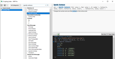

You might have to use separate << Specify Contours.
Slightly modified from scripting index example:
Names Default To Here(1);
dt = Open("$SAMPLE_DATA/Little Pond.jmp");
obj = dt << Contour Plot(X(:X, :Y), Y(:Z));
min_c = -4;
max_c =8;
obj << Specify Contours(
	Min(min_c),
	Max(max_c),
	N(4)
 Edit:
You seem to be missing Min and Max from the command and this seems to work also:
min_c = -4;
max_c = 8;
obj = dt << Contour Plot(X(:X, :Y), Y(:Z), Specify Contours(Min(min_c), Max(max_c), N(4)));
-Jarmo
