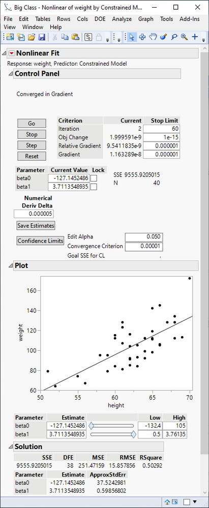

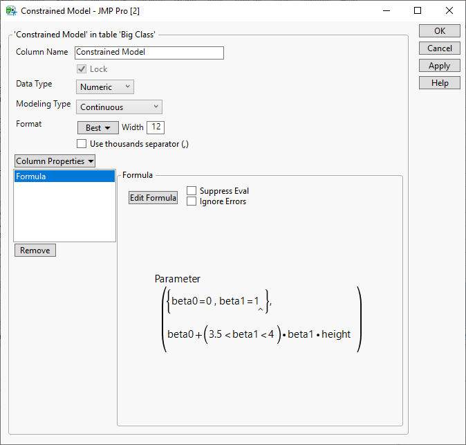

This example illustrates the approach using weight versus height in the Big Class data set. Define the model as a column formula in a new data column: I wanted to constrain the slope to 3.5-4.0 in this example.

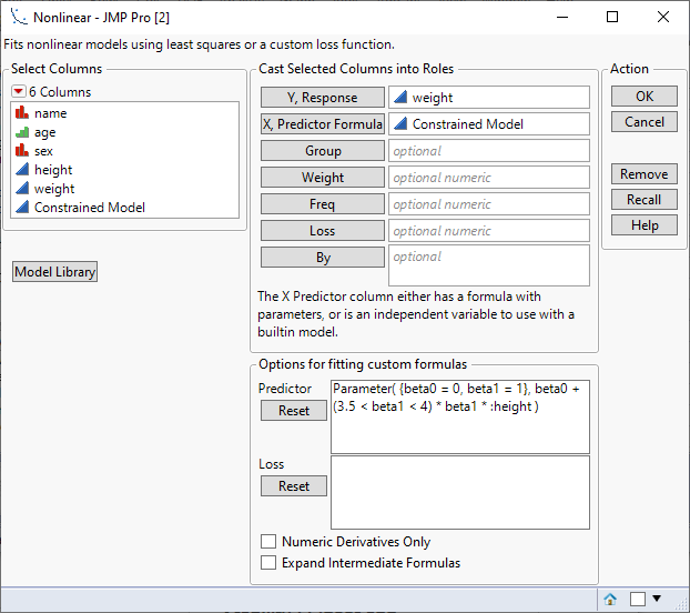

Select Analyze > Specialized Modeling > Nonlinear and complete the launch dialog like this:
Click OK and make sure that all the criteria are correct before clicking Go.

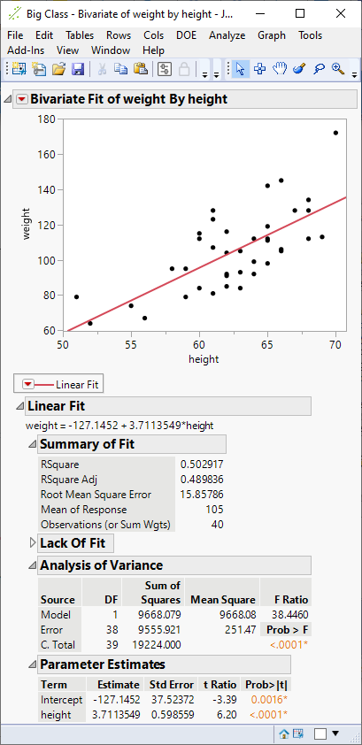

Here is the equivalent fit using Bivariate.
