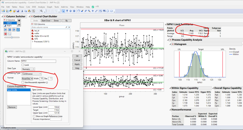

The number of decimals displayed in the Limit Summaries can be set by specifying the Format for the column in the data table.  However, it does not seem to change the Label display on the chart
