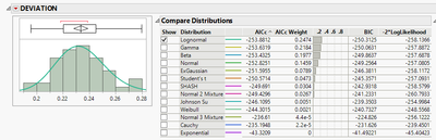

This might be a big ask, but can someone help with a script to try and select a normal distribution when it is pretty close to the best fitted distribution?
So here's what I'm hoping for:
When you click fit all in Distribution platform you get a lot of fits
However, if the AICc of the best fit is within 5 of the normal distribution you might as well use the normal fit.  Sooooooo, if there a way to script something that would go through a bunch of columns that have already had the best fit ran and then adjust the selected fit (assuming it is non-normal) to Normal if it is within an AICc of 5 to the normal distribution?  Bonus points would be for being able to have an input box to enter the delta of the AICc you are willing to live with.  Double bonus would be to remove Students t, Cauchy, and ExGaussian from the selection options as you can't calculate process capabilities on these distributions (and that will be the next step to run after this clean up script is ran).
I've tried and can't get it to work, any help would be greatly appreciated!!
Steve

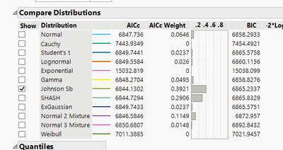

Yeah the platform would still be open and all the best fit comparisons are still there.  I think ideally the comparison box is still there but I can live with just the best fit if that is a lot easier.
So starting here
and for something like this fit, normal would be chosen, however lets say that Normal was way down the list, then SHASH would be chosen
Here normal would be chosen as it is within 5 of Johnson Sb's AICc value.
Hope this helps and thanks for looking at this!

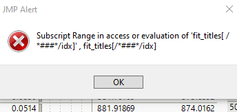

I tried running it and got this error
From the log:
Subscript Range in access or evaluation of 'fit_titles[ /*###*/idx]' , fit_titles[/*###*/idx]
at line 54 in C:\Users\steve.hampton\OneDrive - Precision Castparts Corp\Documents\Script 3.jsl
jthi
Re: This might be a big ask, but can someone help with a script to try and select a normal distribution when it is pretty close to the best fitted distribution?
You have to start adding debug prints and check where it goes wrong. You might have to change the loop from N Items(dists) to N Items(fit_titles) or something.
-Jarmo

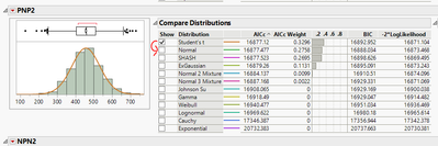

I am hoping that someone can clue me in as the my error in logic or usage.  If no such enlightenment is available, I will turn this over to JMP Support.
Jim

My guess is that the checkboxes aren't really tied to the table box -> when you sort the table box, check boxes do not get sorted properly. And then by default the table box is already sorted in different manner than "default". So you end up in very weird situation where you have no idea which index sets which item as they are not aligned. That is why I went with the very complicated For loop and to check which distribution's Ifbox was enabled.
If you use "default" order (which you cannot set with JSL which causes issues in other platforms also like process screening) you get this
these are the "correct" indices most often.
I haven't yet tried if you could calculate which index is which given the current sort order (or with the knowledge which column was used for sorting).
-Jarmo
