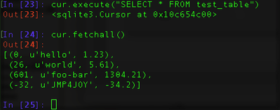

which is exactly what I would expect to find.  I can also query the table directly using the sqlite3 db api for python, and I can confirm that the entries are as shown:

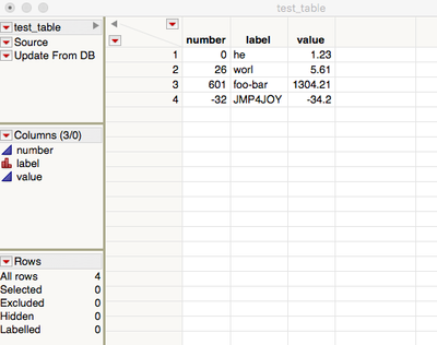

Yet, when I try to load this table into JMP, I instead find this:
Very strange!  It's getting the integer and floating point fields correctly, but it only got the first two characters of the label column correctly for the first row, and it truncated the 'd' off the label in row 2.

Hey, michaelaschmidt0,
I am able to replicate the problem you describe at JMP 11.2.1 on the Mac, but then I tried JMP 12, and the truncation did not occur.  I would say your best bet at this point is to see if you can get to JMP 12 (or 13, just released last week!).

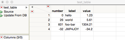

Re: Connecting to SQLite DB
Hi Eric, I've just upgraded to JMP13 and I can confirm that this works.  Thanks for the help to you and everyone on this thread!
