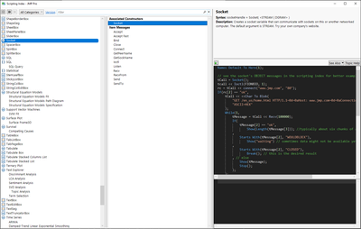

jthi
Re: Connecting and listen to a socket
Scripting Index does have more documentation
and there is also some in Scripting Guide in JMP Help
-Jarmo

Thanks for your reply.
I already checked the scripting Guide, the scripting index and the samples folder, I coudn't find what I'm looking for.
I'm trying to find a way to get a single number from a server each time it send it, and for now just print it but I don't want to block my JMP app during the waiting. when this will work I'll use this number to update a graph.
I couldn't find how to start a new thread like it is usually done, any other source/direction will be helpfull
