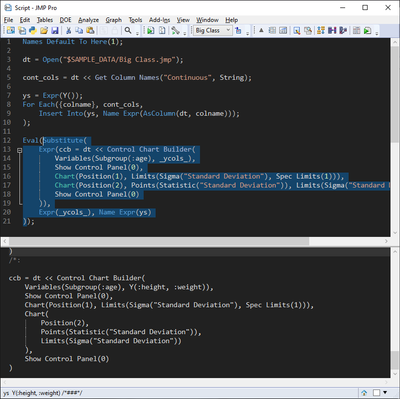

jthi
Re: 変数に格納されたリストを、Control Chart BuilderのYの列に読み込む複数のカラム名として定義したい。
Seems like control chart builder wants to be one of the difficult platforms in JMP. With something like this, you should be able to get all (even the difficult/annoying ones) to work
Names Default To Here(1);
cont_cols = dt << Get Column Names("Continuous", String);
ys = Expr(Y());
For Each({colname}, cont_cols,
	Insert Into(ys, Name Expr(AsColumn(dt, colname)));
Eval(Substitute(
	Expr(ccb = dt << Control Chart Builder(
		Variables(Subgroup(:age), _ycols_),
		Show Control Panel(0),
		Chart(Position(1), Limits(Sigma("Standard Deviation"), Spec Limits(1))),
		Chart(Position(2), Points(Statistic("Standard Deviation")), Limits(Sigma("Standard Deviation"))),
	Expr(_ycols_), Name Expr(ys)
-Jarmo

jthi
ys = Expr(Y());
Eval(Substitute(
-Jarmo

jthi
In most of the platforms you could use Eval() with list of columns but in case of control chart builder it doesn't work and you have to have very specific format to make it work Y(:col, :col2). I build the correct format into ys, Y(:height, :weight) and then use Substitute to add to the Control Chart Builder message so it will be "forced" to evaluate correctly. You can see this if you remove Eval() outside of the Substitute() and run that
You can also check what ys by using Show(NameExpr(ys))
ys = Expr(Y());
Show(Name Expr(ys)); // Name Expr(ys) = Y(:height, :weight);
-Jarmo
