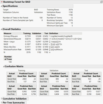

It's strange, relaunching a Bootstrap Forest on this Equity dataset does provide me a confusion matrix :

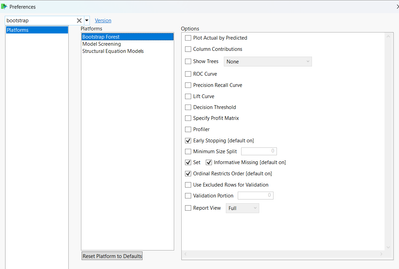

I also checked, and the Confusion matrix is by default displayed in the report, its appearance is automatic and not related to the platform preferences :
You can maybe contact technical support at [email protected] ?
