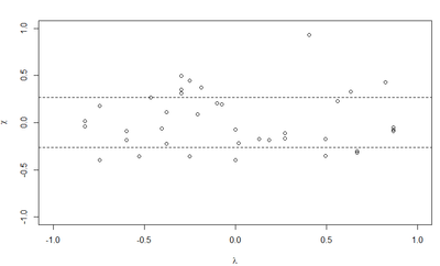

NathanFisk
Level III
Re: Conducting a "chi-plot" in JMP
Here is an example of a chi-plot...
This is a method to quickly evaluate whether two continuous variables are independent.  If they're independent then they'll randomly spread around 0.  I have not seen any method in the Multivariate platform of JMP that will quickly assess the independence assumption of two continuous variables in the way.  Is there a way in JMP to perform this sort of evaluation of variable independence?

NathanFisk
Level III
Alas.  Is there any sort of equivalent test of independence on continuous variables that JMP can perform?
