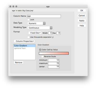

Hi. Does anyone know how to do conditional formatting in a data table column? For example, I want to have the cells in a specific column to turn red when the value is greater than or equal to 0.20. I have found instructions on how to do this in a report but not a data table.

Hi @Michelle_Martin,
Have you tried the Color Gradient column property? Right-click the column you want to format > Column Info. Then, add the Color Gradient column property, check the box to "Color Cell by Value," and click the gradient to set the color theme (or define your own). To have a sharp cut-off, set the Minimum and Center to the same value, and the Max to one unit higher.
I hope this helps!
I hope this helps!

Re: Conditional formatting in a data table
It is easily done using Standardize Attributes. Select all of the columns you want to have the color gradient set for, and then go to the red triangle in the Columns Panel at the left of the data table, and select Standardize Attributes. You can then set the Color Gradient column property, and all columns selected will be set the same.
