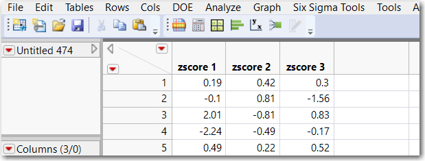

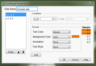

I have a data table with dozens of z-scores derived from distribution stats, therefore the scores may vary from -4 to 4 for example. I want to highlight those numbers: less than -2.1 and greater than +2, basically anything score indicating a value is more than 2 standard deviations. (see screen shot attached)

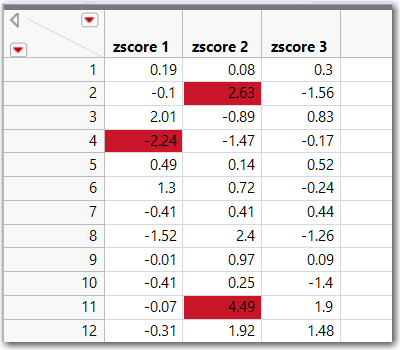

See the attached table. You can do this via the GUI by following these steps for each zscore column:
  • Select the target column and make sure no other columns are selected
  • Main Menu > Rows > Row Selection > Select  Where  [same as Ctrl+Shift +W]
  • Create the criteria: this will be an Or condition [where any condition is met] and press OK. See picture
Conditional Row Selection - Or conditionConditional Row Selection - Or condition
  • Right click ( be careful) and select Color Cells and choose your color.

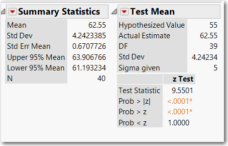

Conditional formatting rules are for reports. See the text changes for p-values in the test of the mean for weight=55 for Big Class data.

I would like to highlight just the cells in multiple columns that meet my conditions. I do not want to highlight the row. I have more than 5 z-scores.
Re: Conditional Formatting Columns in a Table Box
Hello again. Sorry for all the reply postings. I used the code (my first time) and it worked like a charm! Thank you. I will need to research this code so I understand what it is doing.
