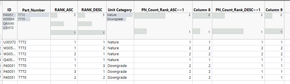

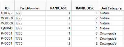

here is my expectation:  for example, In "P40051" group, Part_number of Rank_ASC_1 == "T770", the count of "T770" in this group is 2, similar thing, Part_number of Rank_DESC_1 == "T772", the count of "T772" in this group is 1.  in "Q40040" group, Part_number of Rank_ASC_1 and Part_number of Rank_DESC_1 == "T770", the count of Part_number of Rank_DESC_1 or the count of "T770" in this group is 1. here is my expected result in right 2 columns.
attached the data file for check.

in my table, "RANK_ASC" column have been over there, I am not sure if it's defined by col Rank(:Part_Number, :ID). but I like to base on the value of RANK_ASC (RANK_ASC==1) to find the specific Part_Number, then expect the appropriate formular to calculate the count of Part_number in this group.  in your formular, I have no idea how << tie(minimum) to correlate to RANK_ASC (RAN_ASC==1). by the way, what's the formula for  RANK_DESC==1?

ReliabilityWolf
Level III
Re: Conditional Column number calculation
Thanks for your support, it works
