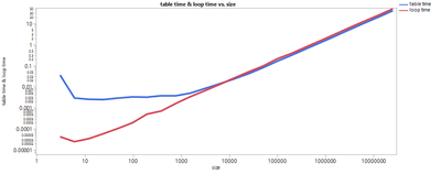

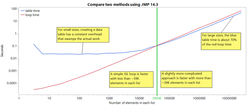

JSL loops have an undeservedly bad reputation. If the guts of the loop do much work, the loop's overhead will usually not matter much. And any solution without a JSL loop is going to involve a loop somewhere else, perhaps in C++ which will be a bit faster, but still. Anyway, here's a comparison of two methods, one involving a JSL loop and one using a loop hidden away in JMP's C++ code.
Graph showing crossover times of the two algorithms at around 39,000 elements.Graph showing crossover times of the two algorithms at around 39,000 elements.

JMP 14 is the oldest I have access to. I think the loop algorithm will have similar performance in JMP 12. It intentionally destroys the two lists as it processes them because older JMP versions did not have fast indexing in lists, but removing the first element is fast. The data table algorithm is first in the loop so it can use the lists before they are destroyed.
Looking back at the JSL, I shouldn't claim either algorithm is simpler or easier to follow.

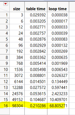

I do have access to JMP14.3 but the script needs to run on JMP12.2 for compatibility within my organization.
I tried your analysis and for JMP14.3 got similar results as you - probably some differences in computing power.
However, JMP12.2 the performance of the loop goes completely out of line. I have to kill JMP.exe process after 98304 as the time was increasing exponentially and never would've hit the 24th row:

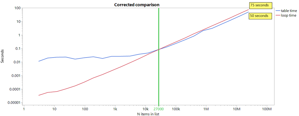

I made a mess of that! Here's an updated version that will probably work correctly in older versions of JMP:

see Fast List  for an explanation; I was concentrating on the RemoveFrom function and forgetting about the Insert Into function.
Insert Into needs a 3rd argument to insert at the beginning of the list, and then a reverse when done.Insert Into needs a 3rd argument to insert at the beginning of the list, and then a reverse when done.
I also renamed the variables in the loop so they would not be using the data table columns as temporaries.
Craige

Thank you this works great. Even though it uses an iterative function it has good performance.
