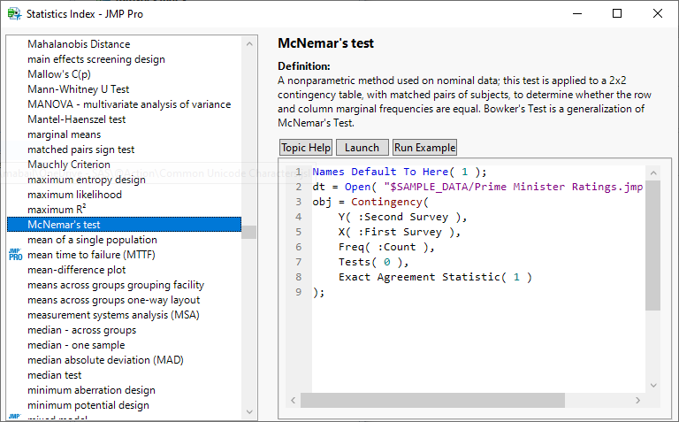

See Help > Statistics Index:
So make sure that both variables use the nominal or ordinal modeling type. Select Analyze > Fit Y by X. Select the test data column and click Y. Select the standard data column and click X. Click OK. Click the red triangle at the top and select the test.
