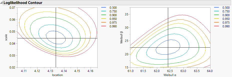

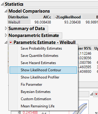

The contour plots for the parameter estimates are available through the red triangle menu of the Parametric Estimate report:
The result is:
The comparison does not directly overlay the contours for the estimates of different groups, though.

Hi Mark, Thanks for your answer. I was aware JMP can show likelihood contour charts for individual distributions. However, I was looking for a (quick and simple) method to overlay two or more such plots on a single chart, because (a) It strikes me as a natural capability of any statistical SW package designed for reliability engineering, especially one intended and designed for providing means for comparing reliability distributions. (b) I’ve found this representation method very useful and illuminating, especially when one need to communicate results to management or other engineers (generally people with less solid statistical background). (c) Most statistical SW packages, including JMP, will provide many methods of comparing the mean of distributions, however, (modern) reliability design practices, comparing the mean is not very useful since we are interested much more in the tails of distributions or in the effect of the entire distribution. Zvika

It is possible to overlay the two contours, but unfortunately I couldn't find a way to change colors and transparencey to make it look nice...
Right click one of the countours and choose
edit->Copy frame contents
then on the other:
edit->paste frame contents.
And make sure both are within the axis scales.

OK. I see your point. Thanks.
I guess it's better than nothing at all but really far from satisfactory.
The list of grievances below are intended to JMP developers, not you:
(a) One cannot control the number of confidence level plots shown (even for a single distribution). It always present 6 plots for confidence levels in the range 0.5 to 0.99.
(b) Some plots are cut when reaching the end of the auto-selected scale. However, these are not re-drawn once the scales are manually adjusted.
(c) As you said, there is no way to control colors and identification of the plotted curves.
(d) It’s a drag to do it over and over again if you are comparing several distributions and/or performing multiple analyses.
regards,
Zvika Bar-Kochva
Re: Comparing Life Data Sets
Your points are well-taken. You can currently compare the likelihood contours of different groups with side by side plots, not overlaid plots.
Please add your suggestion to our Wish List. You will find a button in the menu at the top of this page.
