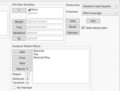

I get overfitting when I try to do it that way. A few of the tests are missing the second time point and many of the values are repeats if the measurement didn't change across sampling points. I am wondering if that is what lead to this outcome. Very odd that I dont have any DF for my day variable. Any suggestions? Thank you!
Re: Selecting a test to determine when to end an experiment?
I am sorry. The two-way ANOVA model not be the most efficient give the limited data that you have. There is no replication, so my first approach results in a saturated model.

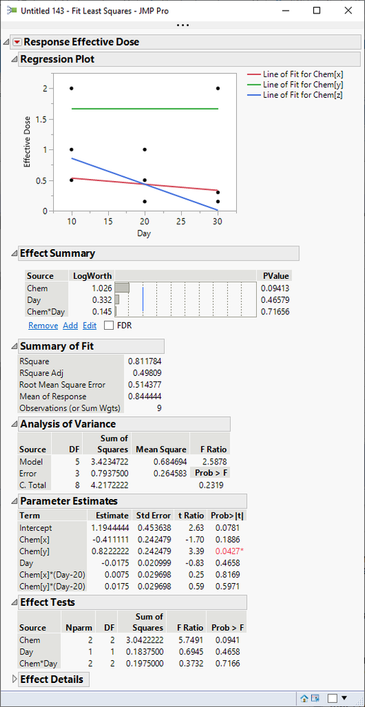

It is reasonable to instead treat Day as a continuous linear fixed effect Be sure that the modeling type for Day is Continuous, not Nominal or Ordinal. Then follow the same steps as I first described. You should get a result like this:
These results suggest that there is a difference in the response across Chem levels, but the Day makes not significant difference.

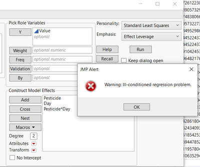

Even when changing day to continuous I get overfitting:

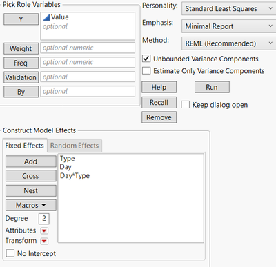

Interestingly if I model Pesticide as a nested random effect under the type of pesticide (nominal classification) and structure the comparison   like a repeated measures mixed model I get meaningful results:
I am conflicted thought, because part of me thinks that pesticide shouldn't be random in this instance. But maybe for the question I am interested in it should be.

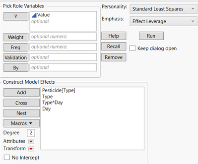

I guess a nested two way anova will work for my needs. But I wonder why it was overfitting with the non nested?? Let me know if you have thoughts

You keep changing the situation. What is Type? Is it really nested with Pesticide?
There is something more to your data than what you showed initially. You had a number of Pesticides observed on three separate Days. The model I showed should work unless there is a data problem. Missing data? Different values for Day?

Sorry for adding more confusion Mark! Once I removed the pesticides that had missing data it ran. I very much appreciate your help.
"Type" is a broader pesticide class that each pesticide can be classified as. I forgot to mention that variable. Therefore I think it would be good to nest each pesticide under its classification because it explains a good deal of the variation based on other tests I have run. One last question: because my data is non normal and I am running a nested regression model, I should test differences on the regression using a non parametric test right instead of an ANOVA. Is there a non-parametric that is good for this type of comparison? Thanks again for all your help
I like that you included Type and nested Pesticide in Type. It obviously improve the model and interpretation of the data. An alternative is to 'discover' types instead of imposing types. For example, you might omit Type from the model, then save the parameter estimates to a new data table and chart them. Look for patterns while adding Type to the chart in the Color role.

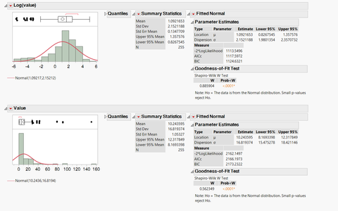

What do you mean by "my data is non-normal?" The related assumption in the linear mixed model is that the errors are normally distributed. Did you analyze the distribution of the residuals or the response to verify this assumption?

Re the normality:
I have been running this on the nominal recorded data values (non normal) but even when log transformed the data is non-normal:
However, the eyeball test tells me that I should be running these test on the log transformed data because it is "more normal" for sure.
