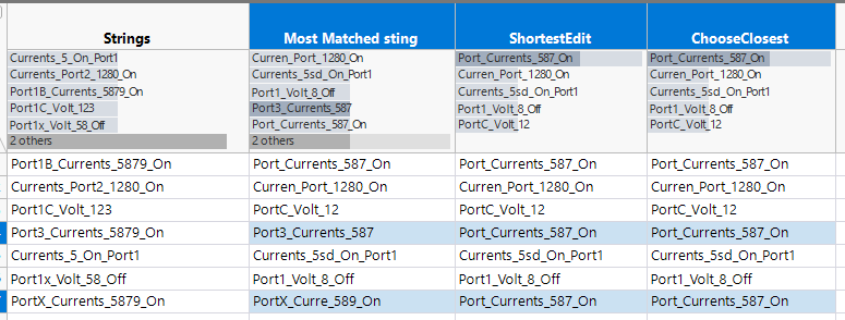

Hi,
here is an example of a list
Here is the final result I would like to achieve:
Thanks,

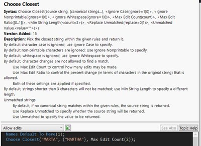

For matching strings one of these might help Shortest Edit Script and Choose Closest (scripting index isn't able to get link for help page for this).
Edit:
Link from JMP help Identify Differences Between Strings, Lines, or Sequences (jmp.com)

Most likely your algorithm wouldn't consider those equal. If I would have to make a guess, quite many would consider the second option closer as it requires less edits. For simple check using shortest edit distance() you could just check for inserts, removes and how many letters were edited. Choose Closest() might be a bit more brute-force method as you could just allow it use 9999 edits or something similar.
My fairly quick solutions disagree with Most Matched string you provided (would just just wish to check how long common sequence there is at the beginning)

Did you manually create the ShorestEdit/ChooseCloset Columns in the above snippet? If not, do you mind sharing your logic?
Thanks,
jthi
Re: Compare strings and assign most matched
Too much of a work to try manually calculate the closest matches so I did use those functions which I have mentioned.
Choose Closest is very easy to implement if you check the scripting index example which allows edits (first argument is your value in table, second is your sample list and increase max edit count as necessary).
Edit: Here is the script used to create the table
