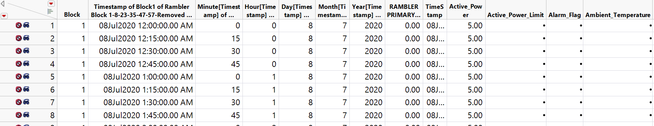

Table 1:  Timestamp (in 15 minute intervals),i1,i2,i3,p1,p2,p3,p4,.... (182 columns)

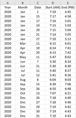

Table 2: Year, Month, Date, StartTime, EndTime ( StartTime and EndTime is in the format- h:m am/pm)

Table 1: Like this I have 15 minute interval data for the whole year.
Table 2: Some times this table has all the dates in the month. Here in the sample there is just a few in each month.
Jim, Let me know if this is helpful.
