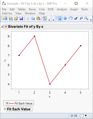

If you are using Graph Builder as the platform to display your graph, right click on the graph and select
     Add=>Line
If you are using the Fit Y by X platform, click on the red triangle and select
     Flexible=>Fit Each Value
I suggest you take the time to read the documents Discovering JMP under the Help pull down menu, and the Essential Graphing in the JMP Documentation Library under the Help pull down menu

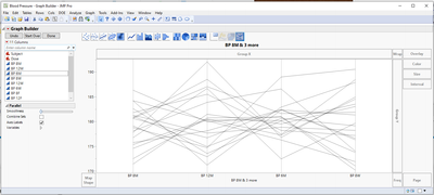

Re: Comment faire un graphe avec des courbe?
Merci pour ta reponse, mais lorque je fais un graphe avec un groupe de plusieurs paremtres sur l'axe X. Je n'arrive pas a connecter les points entre eux?
Le probleme ne viendrait il pas des types de varialbles?
Is this what you are looking for?
If not, could you provide a mockup of what you want, and what your data table looks like?
