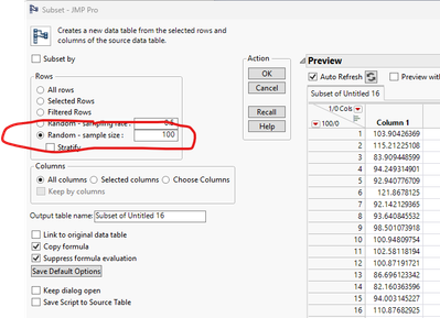

The simplest is to use the built in capability of the Subset platform
     Tables=>Subset

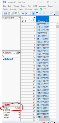

Given a table with a column of data with 1000 rows

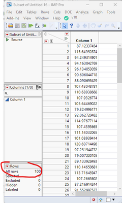

The Tables=>Subset allow you to create a random sample of either a given percentage or a given sample size
Which will give you a new table with 100 rows

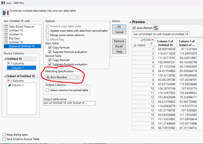

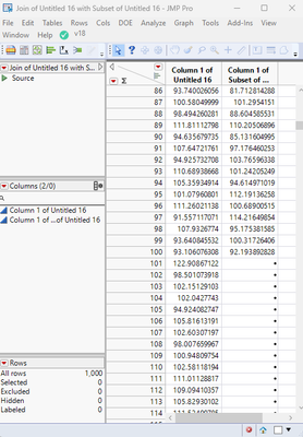

it is then a simple matter to join this table with the original table using
     Tables=>Join
Which will give you what you asked for
The main problem with this approach is that it is somewhat violating the assumptions of a JMP data table.

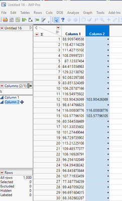

Which produces

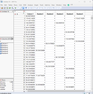

Now if one moves the sample generation to JSL, it becomes a fairly easy task to create as many samples as needed
Names Default To Here( 1 );
dt = Current Data Table();
rowCount = N Rows( dt );
// Create 5 Random Samples of 100
For( k = 1, k <= 5, k++,
	dt << New Column( "Random" || Char( k ) );
	sampleMatrix = [];
	For( i = 1, i <= 100, i++,
		found = 0;
		While( found == 0,
			row = Random Integer( 1, rowCount );
			If( N Rows( Loc( sampleMatrix, row ) ) == 0,
				found = 1;
				sampleMatrix = sampleMatrix || Matrix( row );
// Write the values to the new column
	For Each( {row}, sampleMatrix,
		Column( "Random" || Char( k ) )[row] = :Column 1[row]
Which creates

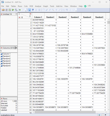

With a little modification, the random sample generation can be sampling without replacement
masterSampleMatrix = [];
	sampleMatrix = [];
		found = 0;
		While( found == 0,
			If( N Rows( Loc( masterSampleMatrix, row ) ) == 0,
				found = 1;
				masterSampleMatrix = masterSampleMatrix || Matrix( row );
