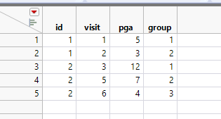

One option is to create new grouping column with something like
Col Cumulative Sum(1, :id)
after this you can split the table
and end up with
then you can move the columns around
-Jarmo

that works!  Thanks
