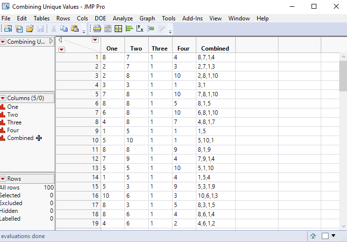

Here is one way to solve this question.  I have created a formula that combines the unique values from a list of columns.  I have attached a sample data table with the formula applied to the last column
Below is the formula used
