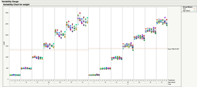

Plotting the data is a great way to start.  I have attached a simple chart showing the weight by trial and age, coded by pen.
Weight vs. Age (days) separated by Trial
Obviously you have pen-to-pen variation (there may be a systematic pattern here).
Looking at that variation (within treatment so not influenced by concentration or form)
R of weight within treatment
So obvious age differences and pen-to-pen variation.  Does not appear to be much due to the factors you manipulated, concentration and form.  This could be due to the level setting of those factors (not sure why you chose 3 levels for concentration unless you predicted some non-linear effect) or they don't have an effect.

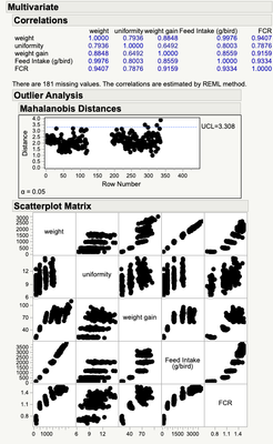

First I would determine if the variation you see in the response variables was of practical significance.  Then I would do multivariate analysis of the multiple Y's.  Do you expect any of the Y's to correlate (or not)?  Why?

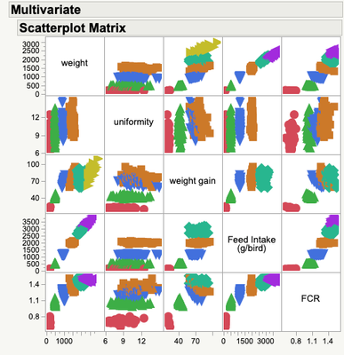

Weight is highly correlated with 1. Feed Intake, 2. FCR 3. Weight gain and 4. Uniformity though some of the patterns in the data are of interest.
Color/Mark by Column: Age exposes the relationships are significantly impacted by Age.

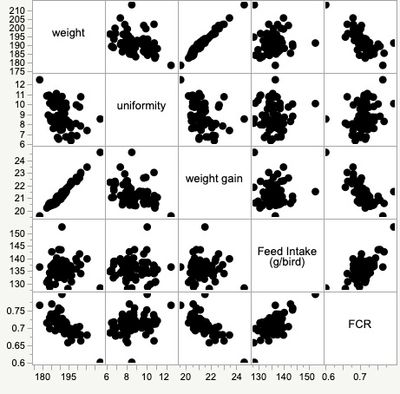

Doing the multivariate analysis BY AGE, may be more insightful.  Example for Age = 7
Scatterplot Matrix
Notice above there is little relationship between Weight and Feed intake.  And Weight and FCR are now negatively correlated.
