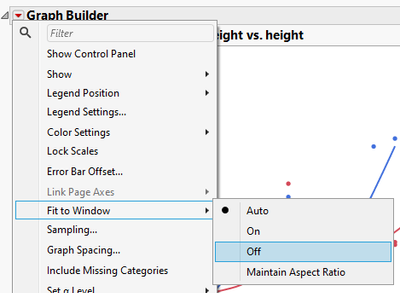

@DualARIMACougar can you clarify how the figures are not what you expected?
Two things that I suspect may be an issue:
  1. When you use Combine Windows, JMP will create a layout that approximates how the windows are arranged on-screen.  If you have two windows side-by-side, the result will be combined horizontally.  If you have two windows one over the other, they will be arranged vertically.
  2. Graph Builder stretches by default, and when combined into a Dashboard, the reports will still stretch by default.  You mention that you have dozens of graphs, so the combined report may shrink each graph to fit on the screen.  One option might be to turn off the Fit to Window option in the Graph Builder reports:
If it is not possible to arrange the windows on-screen as you would like, you can construct a specific layout using Dashboard Builder, which also allows reports to be Tabbed, in addition to horizontal/vertical layouts.  Or you can script the result directly using New Window() as @jthi suggested.

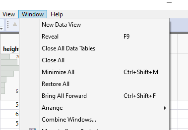

Easiest option is to build dashboard using Combine Windows

Re: Combine several Graph builder figures and export them together as interactive html
Hi Jthi,
I tried this and this does not work at all. all my figures are scewed in this dashboard.
