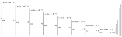

So what I ended up doing is creating a nested IF shown below. I then went in and added Value Labels for each of the points and I get essentially what I am looking for but I am curious if there is a better way to get where I have ended up. I have attached the sample data which includes my solution.
Couple notes on what I wrote, the final if statement is completely unnecessary and having Error outside of quote would, ironically, cause an error.
