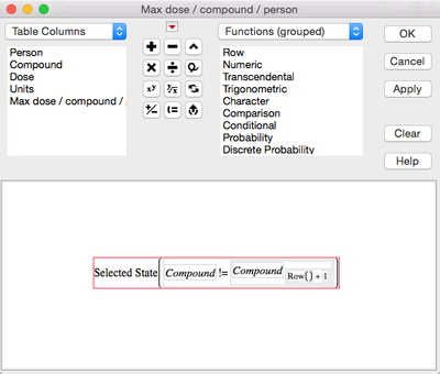

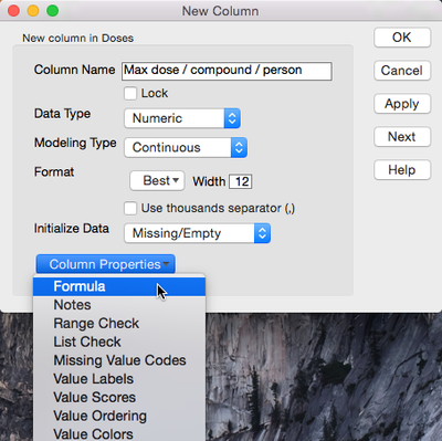

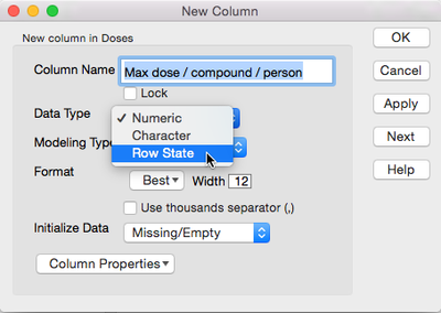

Then create a Row State column (Cols -> New Column).
And add a Formula.
The formula should be:
Selected State( :Compound != :Compound[Row() + 1] )
In the formula editor it looks like this:
This will select any row where the compound name is different from the compound name in the next row. Since the table is sorted by person, compound, and dose these rows will represent the maximum dose for each person.

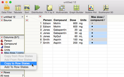

You can then copy these selections to the active row state area using the pop-up menu next to the row state column name.
The rows will be selected and you can use Tables->Subset to get a new data table with just the selected rows.
I've attached a data table that shows this.
-Jeff

Jeff_Perkinson
Re: Row selection based on multiple columns and multiple criteria
Byron is right. I was a little too quick and forgot that if two people in sequence are taking the same compound then my condition won't catch the first one.
Here's a corrected formula and data table.
Selected State( :Compound != :Compound[Row() + 1] | :Person != :Person[Row() + 1] )
This time it selects the row if the compound or the person doesn't match the next row.
-Jeff
