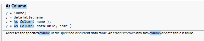

Could you please include in your answer a reference that explains this bit?
"As Column() "accesses" a column (what this means depends on the case...)."
jthi
Re: Column() vs As Column() vs datable:column vs dt:As name("column")
Best reference (outside of my own experience and lots and lots of trial and error) is from scripting index:
Help pages is other place Column(<dt>, "name", "formatted")  and As Column(name). This also has some information  Scripting Guide > JSL Building Blocks > Rules for Name Resolution > Frequently Asked Questions abou... and  Scripting Guide > Data Tables > Columns > Send Messages to Data Column Objects also Iterate on Rows in a Table , so basically the documentation (especially Scripting Guide).
