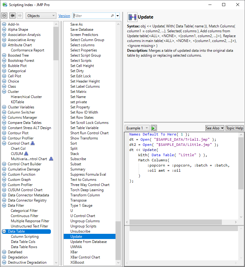

The problem might be the syntax for the << Update(... ) message. Try this syntax for Match Columns() argument:
Match Columns (Column(out) = Column(out))
You are not testing equality. You are specifying a match. See the syntax for this message in the Scripting Index:
