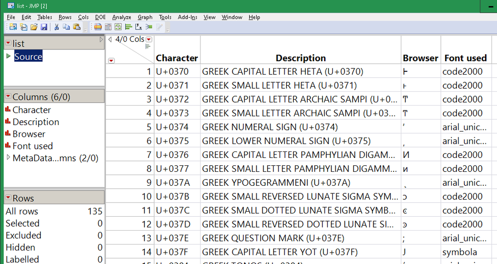

Craige_Hales
Re: Column Formula to convert Unicode to symbol
something like
beta = "\!U0392";
theta = "\!U0398";
Or maybe
Open(
	"http://www.fileformat.info/info/unicode/block/greek_and_coptic/list.htm",
	HTML Table( 1, Column Names( 1 ), Data Starts( 2 ) )
which makes
Table loaded from URLTable loaded from URL
I like that site for finding characters; make JMP's \!U version from theirs
http://www.fileformat.info/info/unicode/char/3b2/index.htm
They show U+0392, JMP uses \!U0392
Craige

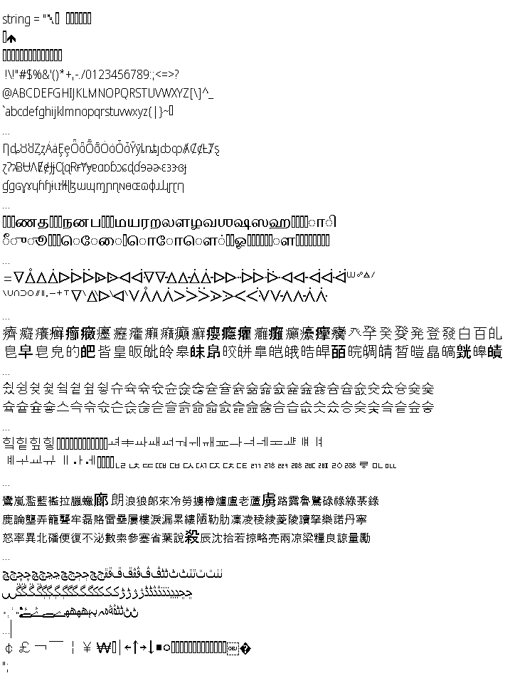

Craige_Hales
回复: +Re: Column Formula to convert Unicode to symbol
Looks right. I'd do it with the matrix-blob conversion like this
linelength = 32; // break lines every 32 characters
mat = 0 :: 65535; // useful to start at 0, but null is a problem...
mat[1] = Hex To Number( "2400" ); // fixup null character
mat = Shape( mat, N Cols( mat ) / linelength ); // reshape to concatenate new lines
mat = mat || J( N Rows( mat ), 1, 10 ); // newlines(10 decimal is 0A hex) every linelength
blob = Matrix To Blob( mat, "int", 2, "little" ); // little endian 16 bit matches utf-16
string = Blob To Char( blob, "utf-16" ); // done!
Show( string );
to get
many characters removed for this picture! Using notepad and a notosans font.many characters removed for this picture! Using notepad and a notosans font.
