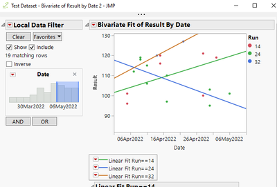

Hi,  I plot a bivariate fit and fit a linear line for each "run". The colors on the row legend match the colors of the linear fit lines (see pic 1)

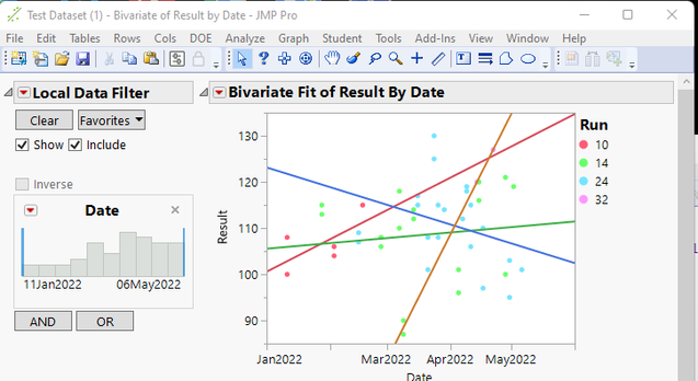

When I apply a local data filter and change the "Date" and therefore the "Run" may change, the colors on the row legend do now match with the colors of the linear fit lines. See pic 2, the Run 14 is red dots but the linear fit line is green.
Is there any way that the row legend and linear fit line can always be the same? I have attached the data table and script.
picture 1: colors in the row legend match with the colors in the linear fit line.
picture 2: colors in the row legend do not  match with the colors in the linear fit line.

You are removing the selection of the Value Color when you are specifying the Line Color on the Fit Where.  Below is an example where the colors remain the same

Set the Column Property, Value Colors for the Run column, and when the local filter changes, it will always use the Value Colors set for each llevel of the Run column.

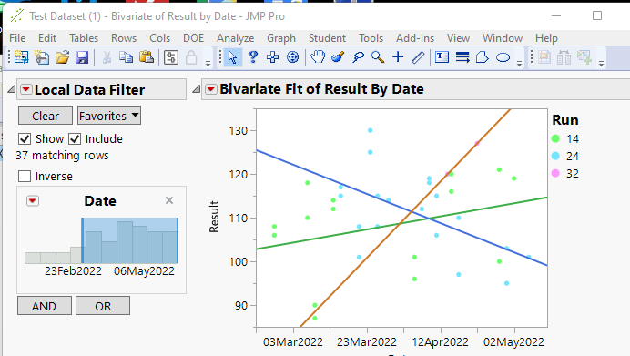

I think that I am still doing something wrong. This is the code that I am using. The data table is attached to the first post in this tread. When I move the local data filter by date, one of the Runs disappears and the colours change. What am I doing wrong?
