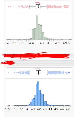

I am trying to use distribution to create histograms By(: DeviceID), However when I apply the fill color only the last graph in the By statement gets changed to light blue. No matter what I do, only the last graph changes color. I just want the graphs to not be green.
Options that work for me:
1) color histograms by device ID
2) color histograms both to be blue
WaferRgPastMonth << Distribution(

txnelson
Re: Color Histograms with By statement in Distribution
If you restructure your code, you will be able to set the histograms to the color you want
names default to here(1);
// Open Data Table: big class.jmp
// → Data Table( "big class" )
dt = Open( "$SAMPLE_DATA/big class.jmp" );
dis = dt << Distribution(
	Stack( 1 ),
	Continuous Distribution(
		Column( :weight ),
		Quantiles( 0 ),
		Summary Statistics( 0 ),
		Horizontal Layout( 1 ),
		Vertical( 0 )
	By( :Sex )
dis<<histogram color("blue");

Thank you so much!!
