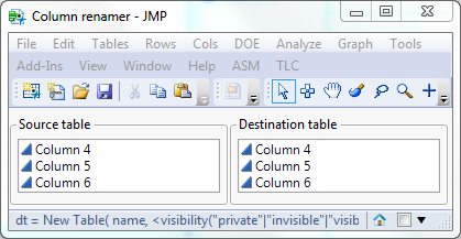

I want people to select two data tables and then display the columns in those datatables in two col list boxes. However when I set the columns in the boxes, JMP will only set the columns from the active data table and will not respect the data table argument. Any suggestions?
Here is a quick example of the wrong behavior:

This results is:
The expected result is that in the left list the columns 1,2,3 are shown since those are the names in the first table. Instead it is showing the second table (the last created and as such the active table) twice.
