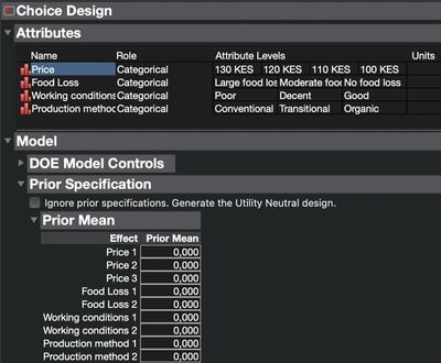

A couple of weeks ago, I did a pilot Choice Experiment among 20 consumers in Kenya. Now I would like to use that information as 'priors' for my final Choice Experiment that I'm designing in JMP. However, I'm not sure how/where to fill in which data.
These are my attributes and levels:
These are the priors (from the pilot study):
But I’m not sure how to fill them in in the final Choice Experiment design. When I want to fill them in in the ‘Prior Mean’ table (see screenshot 3) I don’t know which information to fill in where. For example: where do I fill in the ‘price 100 KES’ estimate of 0,178, does it correspond to price 1, 2 or 3? Maybe it doesn't matter if I fill it in under price 1, 2 or 3?

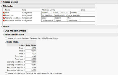

  • Enter factors, levels and prior means estimates :

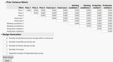

  • Calculates prior variances by squaring the values of Std error estimates for each factors levels from the pilot study, and enter prior variances estimates :
You have then to define finally the details for the design generation : number of attributes that can change in a choice set, number of profiles per choice set, etc...
Here is one example script of a generated design :

I did the exercice with your data if you want to have a look (but the levels ordering for the factors may be different, so that I can have all parameter estimates and Sdt error estimates values needed (without calculation) for the prior mean and prior variances panels) :
