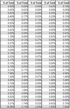

Changing the % of Total Tabulate statistic to calculate based on the grouping column
In the plot below, the percentages are being calculated with reference to all of the values in the entire table, but I would like for them to be calculated with respect to the value in each grouping column. In essence, I want all the percentages in each column to add up to 100% for each indiviual column, instead of them adding up to 100% across all 5 of them.

Did you generate this from the Tabulate platform? If so, there is a Column% option you could use rather than the % of Total. If this is not from Tabulate, where did it come from? That will help us figure out how to get what you need.

Yes, this is done via tabulate
Re: Changing the % of Total Tabulate statistic to calculate based on the grouping column
Then using the % of Column statistic should work for you.
