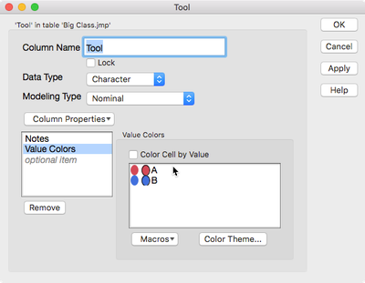

Try using the Value Colors column property.
:Tool << Set Property( "Value Colors", {"A" = "Red", "B" = "Blue"} );
-Jeff

Jeff_Perkinson
Re: Changing fit line color while using fit model
-Jeff
gzmorgan0
Super User (Alumni)
Jeff,
This is cool.  Yes, this does force the line to be colored by the Value Colors().  I found that Using JMP documents that Value Colors()  is one of the column properties that "attach information that is used in reports and plots" but it is not very specific. It would be nice to add what it does.  Note that :sex is a modeled factor, yet the points do not use it. So maybe another sentence or Tip of what it does vs. doesn't would be nice to have.
Since this is related to Fit model, it would be nice if a colum's predicted and residuals would also use the associated table's Value Colors(), so that Leverage plots, etc. would use that coloring as well.
Thank you for documenting this.
AnneMaryJoy
Level II
Hello Jeff,
Your method worked as well! Thank you very much for the simple solution!
