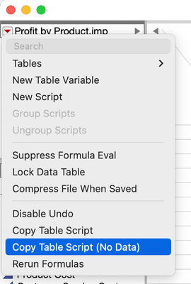

Similar to @jthi's suggestion to copy the script of each column, you can copy the script of the entire table without the data using the Red Triangle (at the top left of the table) > Copy Table Script (no data).
The script will contain the jsl to recreate your table, which will include all your column formulas. Paste that script into a script window, and search from there.

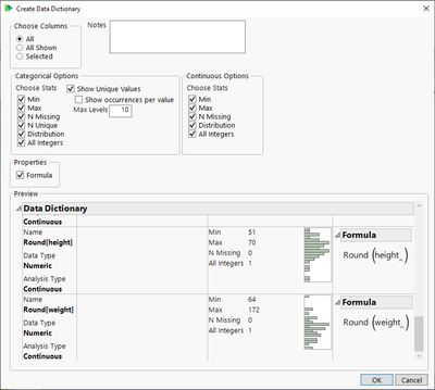

Unfortunately, I don't have JMP Pro. For some reason, the error message I get when I try to delete the column does not list the column containing the formula. I don't know why. I also thought that the data dictionary might be able to help but I couldn't see how once I looked at it. Thanks for the assistance though.

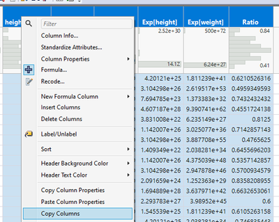

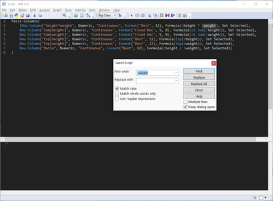

You can select the formula columns, select copy columns, open new script (ctrl + t) and paste there. Then search in script editor.

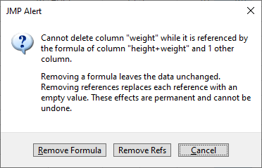

You could also try removing that column and if it is being used, JMP will display warning like

There might be also some way in JMP18 utilizing Columns Manager but I could figure one out. Data Dictionary almost can do it but it stores the formulas as images so they cannot be searched easily
