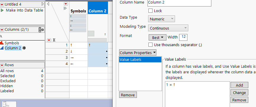

I want to be able to display these symbols
based on a mapping rule (e.g. 1 = ↑ , 2 = ↓ 3 = →, 4 = ←)
in either a data table cell or in a table box() display.
Copying and pasting that symbol into a data table cell or as a list item for a String Col Box() isn't working for me to even be able to display the symbol.

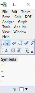

jthi
Re: Can you display symbols in data table cells and Table Box()
For me they do work (Win10, JMP18.0.1)
